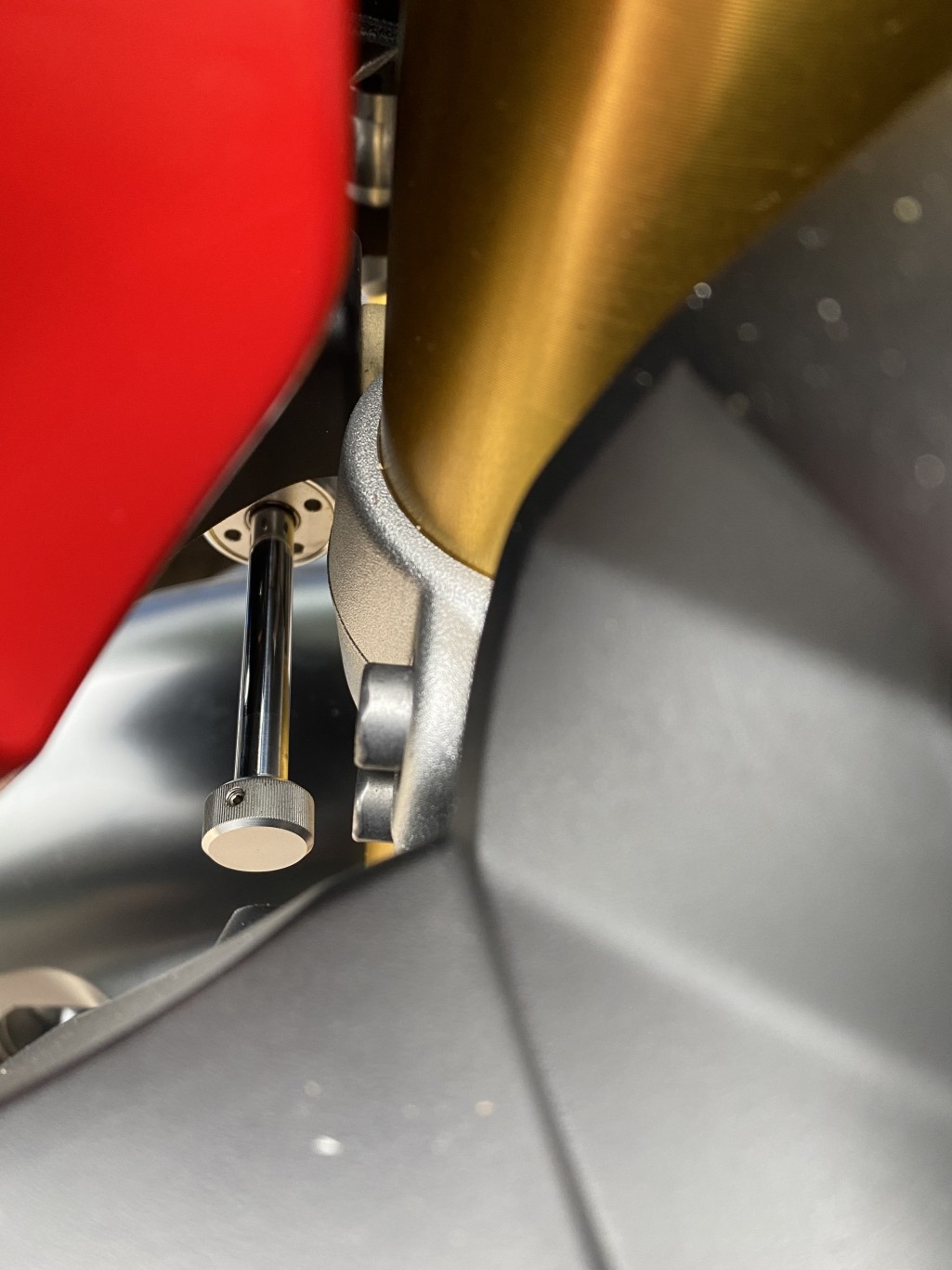

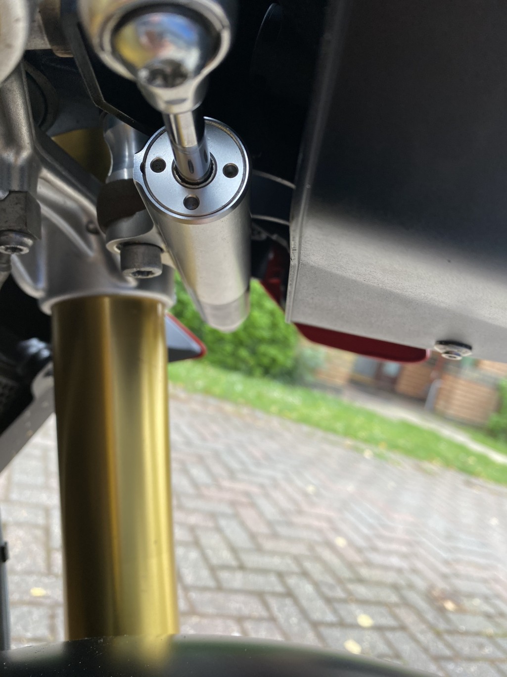

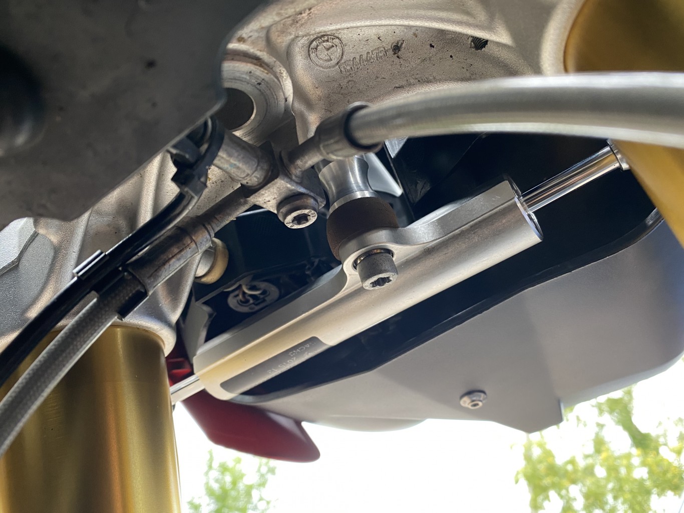

Long story short, found someone on eBay selling an adaptor so the RR damper fits, I've got no affiliation to him at all, though know he has posted on the forum a couple of times recently.  There are other options with dampers with sliding mounts and washers/spacers that I've read about, but decided to go down this route.  Basically the adaptor is a slightly longer version of what is fitted to the R as standard and allows the RR adjustable damper to be fitted directly.
To fit the RR damper using the eBay adaptor -
GEN3 RR adjustable damper - I paid 130 for a used one with 6 months warranty, make sure it includes the rod end fixings as you can't purchase these separately from BMW.
eBay Adaptor - https://www.ebay.co.uk/itm/Bmw-S1000R-steering-damper-adaptor/114288302134?ssPageName=STRK%3AMEBIDX%3AIT&_trksid=p2057872.m2749.l2649 - 30
ISA Screw part number 07129906315 (damper mount bolt) 3.  These are supposed to be single use, the one I removed had a ridiculous amount of thread lock on it and was a bit of a PITA to remove, I'm sure if you clean it up you could reuse it without problem, but Bahnstormers isn't far from me so I just ordered a new one.  When using the adaptor be careful when torque'ing up to the 50nm spec.
The initial fit was really good, though a little tight in terms of clearance, I'm a bit fussy so decided to add the small spacer that came with the RR mount and fit two the foam grommet/spacers.  I think the chap who makes the adaptors is going to make a batch that are slightly longer still and send me one to try, though I am very happy with how the current one fits.
A few pics below, in terms of improvements the front end now feels solid and planted, the DDC still needs attention (Wilber's and springs over winter), I am genuinely surprised at just how much of an improvement this has made.  High speed head shake is gone as you'd expect.
