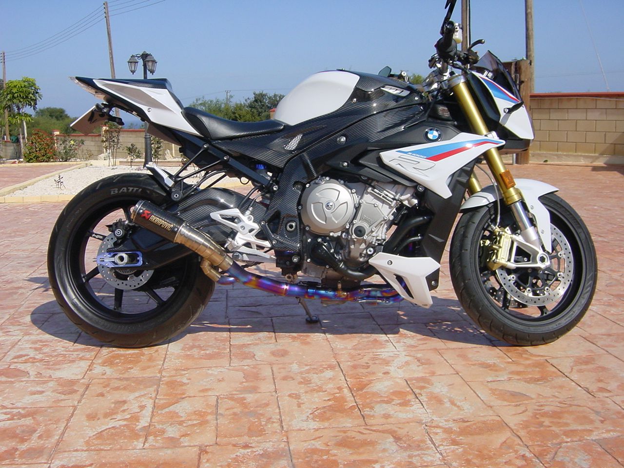

Just installed the akra titanium headers and my short box sounds amazing
not tested yet as i have to weld a small support bracket for the rear foot peg.
I suppose now i will need a fuel controller
The pc5 cannot access the closed loop area and no maps available on the download page
so i dont think this is a viable choice information from there web page
The dimsport rapid bike evo when reading sounds good .
so my question is what has been fitted that really works for the bike stable in low and high RPM  thanks  :005:
