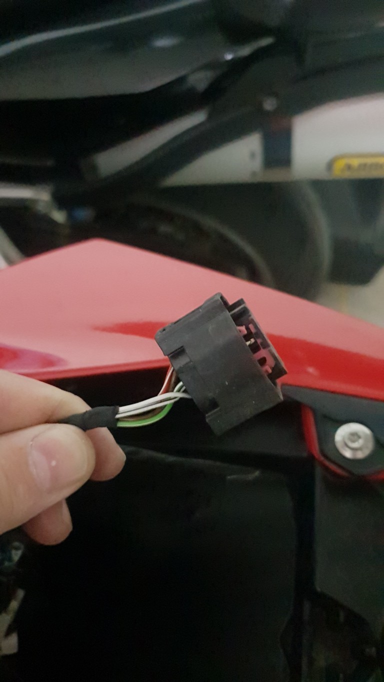

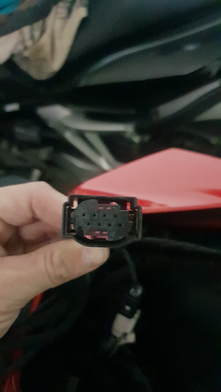

Hi,
Yesterday i finaly received used k1r 16 sport in red from UK with 9k miles, it was a steal, but it has an unknown history on the other hand, bike rides fine and all good only problem is that ABS light is constantly ON (not blinking), anf TC light blinking all the time as soon as ignition is turned on (wirh engine off) and stays the same (abs on, tc blinking) also when moving.
Since is lid immediatelly i think it could be one of the sensor, will diagnose it when i get the equipment.
Anyhow, today looked a bit and found an empty connector in the tail under the seat - does anyone know what it supposed to be and where should it be connected to - if at all.
See picture attached.
Thanx and all the best

I think its the wiring for factory alarm, that sits in the tail

It's normally capped with a can bus terminator.  I doubt that's where your ABS and TC problems come from, though.  I'd look at the wheel sensors for the source of those issues.

Thanks for all the input - looks like the plug is really from alarm DWA unit which was removed at some point out of the bike - no box under the passenger seat - i have an option to put it on or off in menu - will leave it on OFF and wont try what happens if put it in ON mode :D
And is as mentioned, in nocorelation with ABS/TC lights.
