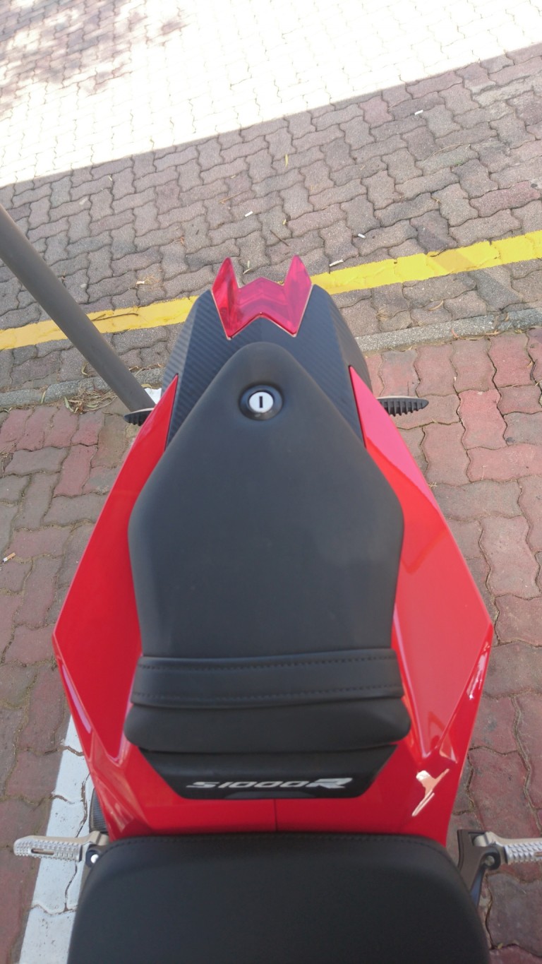

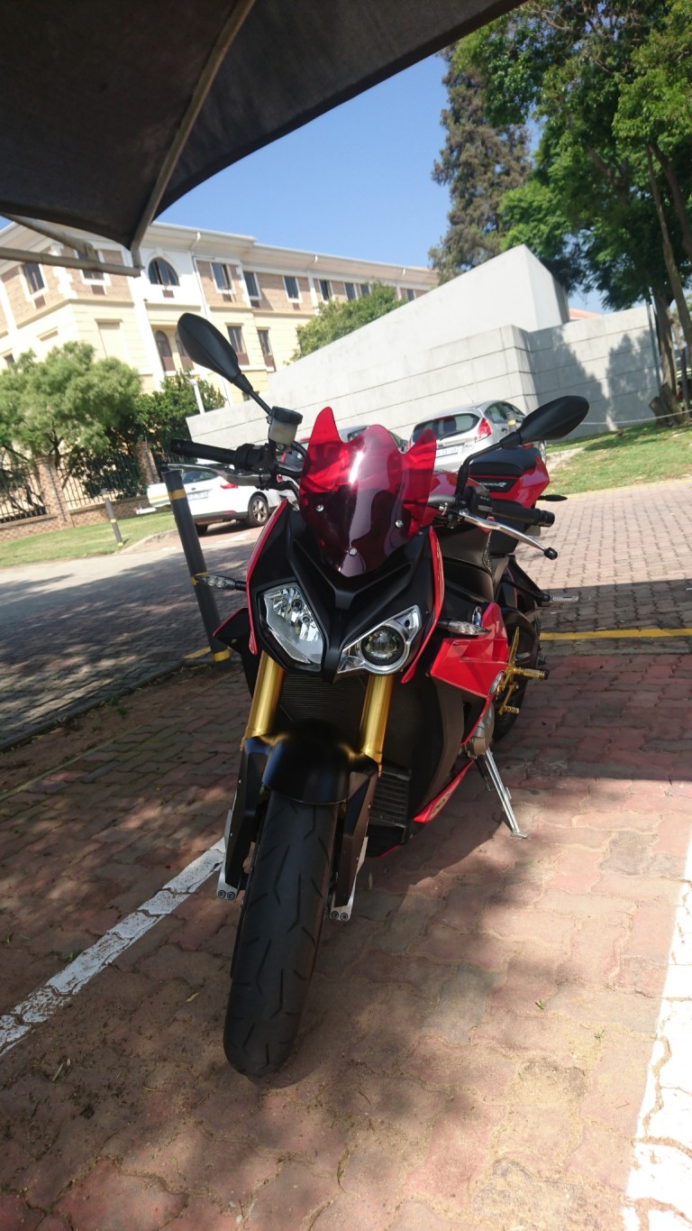

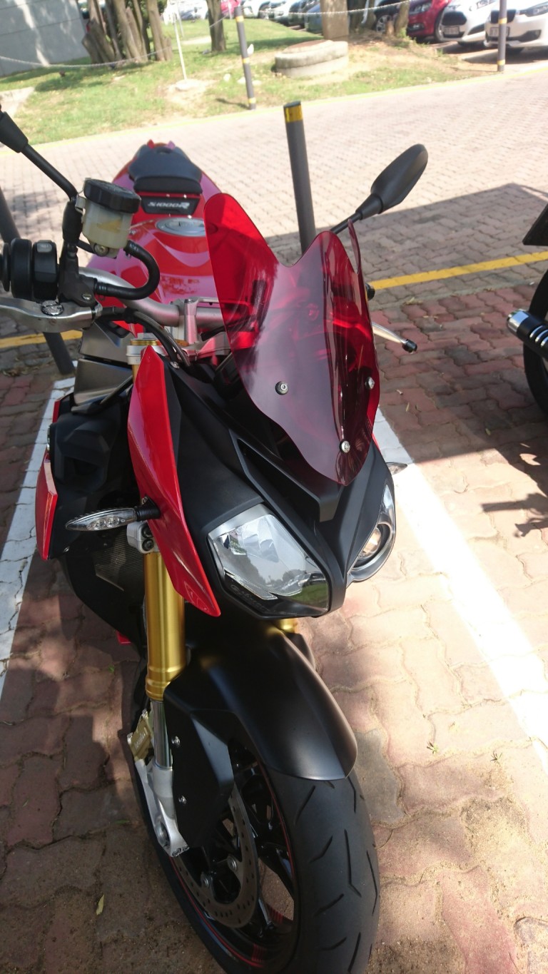

Have a look and let me know what you all think.
Perspex 3mm thick. Heated and treated
Perspex 500mm x 500mm x 3mm - free, cut off from signage place
you need oven, pre heat to 180degrees Celsius , bake the perspex for exactly 2minutes.
you need a mold(i used the stock tiny baby screen)
you need Welding gloves cause it is hot as hell when you take it out the oven then place it on your mold to make your shape.
Drilled the holes in carefully once it is set and cooled down, it is fragile, we broke cracked 2 screens
process is a bit incomplete, i will re-write so that everyone can understand how much work went into it

Impressive workmanship! I would be concerned about the screen being fragile. Could a rock striking it cause it to shatter and send shrapnel into your neck?
Hows the aerodynamics working out?

Aero is a little better. Im not sure about the shattering and gashing neck,sounds like final destination stuff, didnt even think of that. Might have to go with thicker next time. Or will have to somehow test. All depends on speed i guess. And if you hugging down on the tank.

That is awesome. I would have never thought about making my own. I think 3mm is plenty thick, as I have read most screens are made out off 3mm, only Wunderlich uses 5mm. I would actually worry about the top curves. Read were a rider went down and went over the top and the top corner got him in the shoulder. Rounded may be better.

I am enjoying the responses. 5mm would need more time in the oven and i think more difficult to shape.. My Friend has a genuine BMW screen. I might make a copy of that and change the shape just a little. So much cooler having your own design.. I was going to make the top curves sharper but thought of them poking me in the guts if i had to go over the bars. Thanks for another point to think about..
