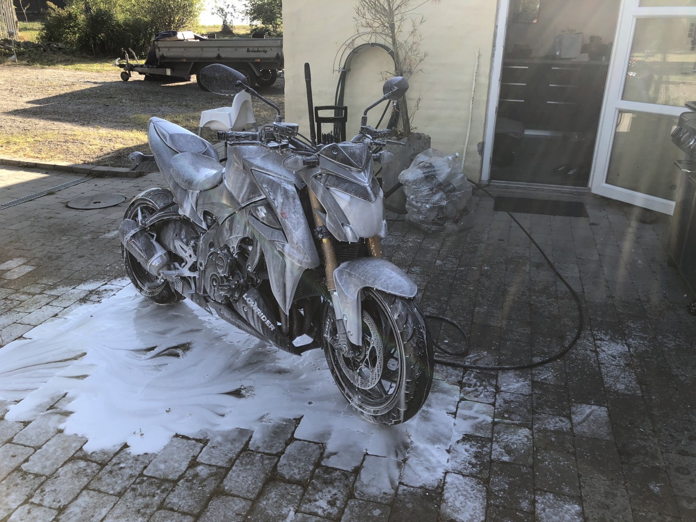

My wife is 165cm, with short legs :) So her GSX S1000 is lowered 8cm or so. Did as you described with the seat, even made a article about it here: https://www.gsxs1000.org/forum/gsxs-1000-appearance-modifications/35466-lowering-shaving-seat-hight.html
In my book a lowering always starts with the seat, if that is not enough then the suspension:
1. Shave seat (or get a lower seat if available)
2. Drop front and rear suspension.
     a. Front is easy, release clamps and rise the setting of the Fork leg ind the clamp. Beware of the risk of the front wheel hitting the radiator when bottoming out.
    b. Buy or fabricate new triangles or dogbone for the rear suspension.
3. Shorten / or buy shorter kickstand (Not easy on the S1000r as it cast aluminum.)
Sorry for the corny wash pic :) But you get the idea..
